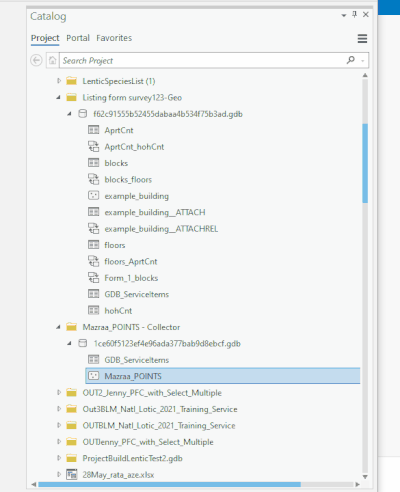

Short version is download the 123 service as a GDB.  Then copy paste that into the GDB with your parent points.  Create a relationship between the parent points and the form.  Publish this new GDB as a service.  Point the form to this new service.

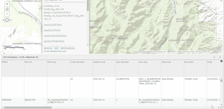

Then in the web map my 10-15 forms I have are all related to the main parent points - which are all the places the crews need to go - and we prepopulate all of these.

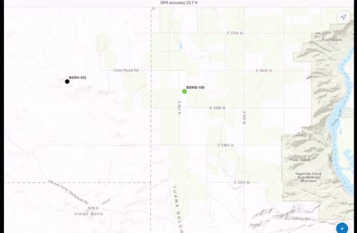

Then we launch forms from that parent passing over the Keys and other info.
