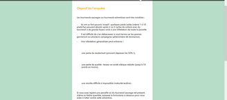

Hi,

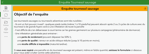

I tried to integrate HTML in my survey (using survey123 connect). This is correct in the preview (you see the text in bold for example....)

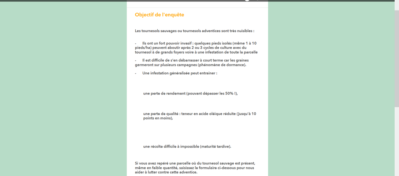

But once time published, the HTLM dit not integrate.
You can see the difference in the picture below between survey123 connect and the same published survey.

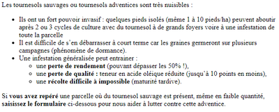

This will resize nicely on the page as well. It looks something like this in a browser:
