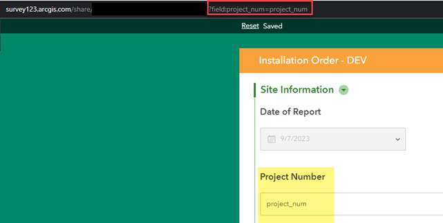

Thanks for the links @IsmaelChivite - however even after following the tips to structure the URL in the form, it doesn't accept a field parameter to pass the answer to the new survey.
This is how I formatted my URL in Survey123 Connect:
And this is what I get when I test it in my survey:
My end goal is to copy over some answers from one survey submission into a new survey submission.

I did not understand initially what you were trying to do. It was explained well in your original post... but I read to quickly... I guess I understand now.  You want to launch a second survey, while passing parameters, once the first survey has been submitted.
Your attempt to hijack the Thank You screen was very clever! However, it will not work.  When embedding content into the Thank You screen we need to do some additional clearing/processing and the syntax is not so straight-forward.
