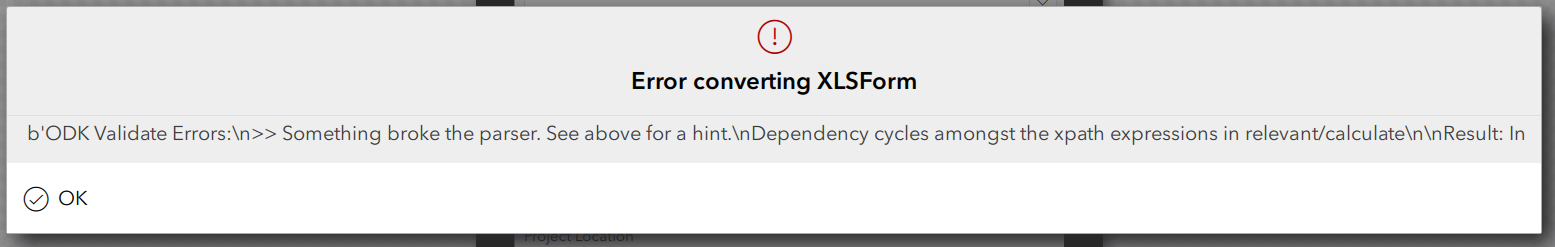

I have a survey form for collecting samples from buildings.  The samples are contained within a repeat ( ${repeat_samples} ).   Within the repeat, I have fields for Building Number, Floor Number & Room Number.  Since multiple samples are always taken from each room, I would like NEW samples to default to the Building, Floor and Room values entered in the previous record.  This is the formula that I've tried using, but receive a dependency cycle error:
indexed-repeat(${bldg_num}, ${repeat_samples}, position(..)-1)

I believe what you are seeing is expected, as you are using a calculation that references a question that uses the answer to calculate itself, hence the circular reference. This is generally an issue with indexed-repeat functions if you use them inside the repeat that it is referring to. For the November update, we plan to update the documentation to say that using indexed-repeat inside a repeat it refers to is not supported.
