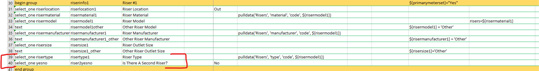

For context, users are entering utility meter attributes to an existing customer meter point. I’m unable to share everything due to confidentiality, but here are some examples as well as my worksheet:

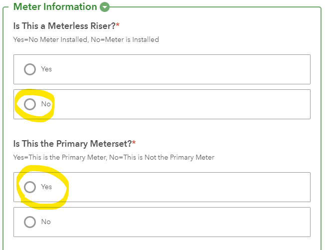

These two questions should have default answers prepopulated (rows 21-22 in excel spreadsheet). I’m not sure if this makes a difference, but the Calculation row is being used later in row 24 to reference the ‘Is This a Meterless Riser’ question.

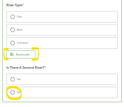

‘Riser Type’ (row 39) is a Select One that has a pulldata expression in the Calculation column. It will only populate if the Recalculate icon is clicked. And ‘Is There a Second Riser?’(row 40) should default to ‘No’.

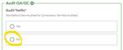

This question of ‘Audit Yes/No’ (row 175) is not referenced anywhere else and the default of ‘No’ does not populate

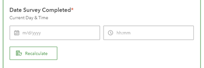

One last example 🙂 The 'Date Survey Completed' (row 17) is set with a Calculation of 'now() ' but it also stays blank until 'Recalculate' is clicked. This same question set up worked fine in the S123 field app, but it looks like this in the web survey.
