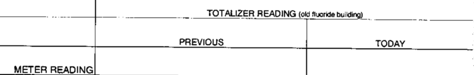

Hello!
I am digitizing a water quality form for a client. In their original form, they ask that for the meter reading from the previous day as well as the meter reading for the current day.
From what I understand, pulldata() works for external datasets. Is there a way to pull the meter reading from the last form that was filled out and use it to populate the "previous reading" question? A way to reference the survey feature service?
I am trying to automate it, because I think having the user close out, open a previous survey, close out of that, and reopen their current form is an inefficient workflow.
