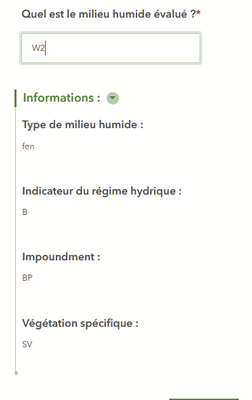

I was able to publish the survey (so far everything seems to be working), but when I test the survey in Survey123 Connect it doesn't work. The questions don't pre-fill when I choose a wetland (I see the question/note title, but not the answer). The same applies to the Survey123 application on the phone. However, if I choose to open the survey on the web instead of the app, it works. The answers auto-complete according to the wetland selected. Has anyone had the same display problem or could you help me identify the problem?

Here is my xlsx and csv files (in attachments).
It doesn't contain much because I wanted to do a test to make sure the function works (or at least understand how it works before inserting it in my final form).
On the Internet, it works:
but on the application, the information doesn't appear :
