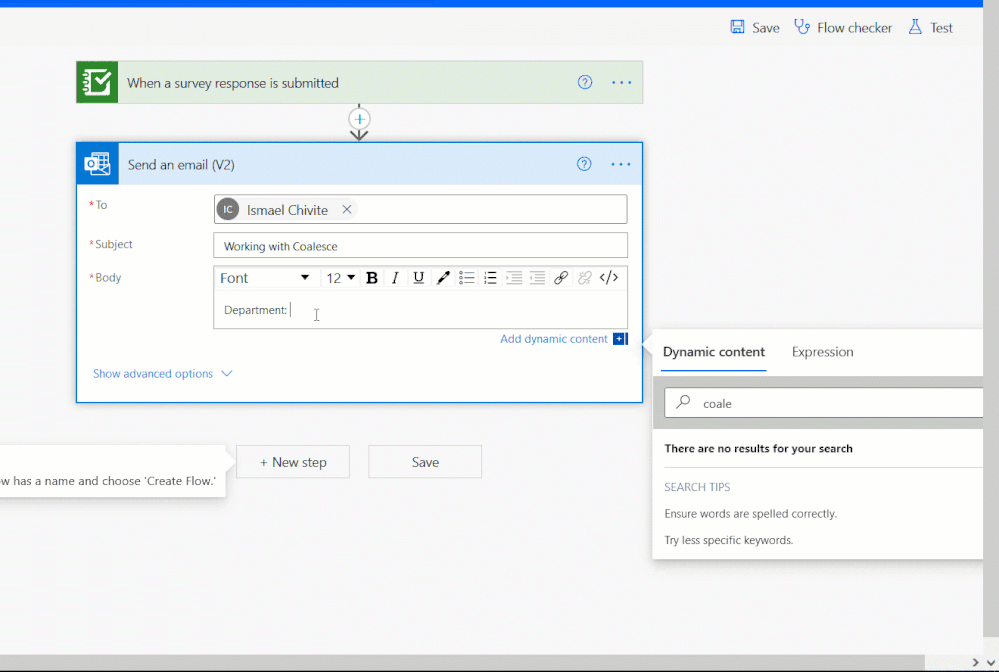

I think the coalesce() function in Power Automate will do the trick for you.  This function can take a value from dynamic content and a fixed string (such as "NA"). If your value from dynamic content is empty, it will return your fixed string.
For example if my Survey123 question called dept is empty, I will get back NA: coalesce(triggerOutputs()?['body/feature/attributes/dept'],'NA')
