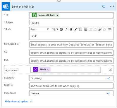

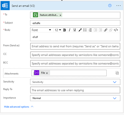

If I remove either of the attachments (so there is just one, either just "Photo" or just "File"), it saves and the flow operates properly.
For example:
or

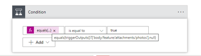

TL2
Also add a condition to check if attachments exist (here I am calling them photos).  If there are no attachments the flow will fail without an condition to send an email without attachments.
