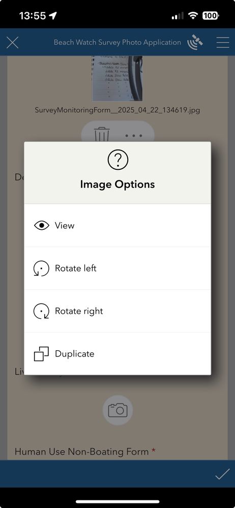

I have an image question in my survey. This particular image question is multiline. After taking the first image, three dots appear below the picture and lead to a window with Image Options. I would like to remove the Duplicate option from the Image Options menu. Is this possible?

It looks like it comes built in with the multiline photo appearance. It seems like the only sure way to get rid of it would be to set up photos in a repeat. However, you might try setting the camera control to camera only, which would eliminate the user's ability to upload existing photos and see if it disables the duplicate option.

Thank you for your reply. A repeat may be the solution, but for some reason I went with multiline. I will have to try a repeat. Currently, I use the camera setting only to collect an image.
Thanks again!
