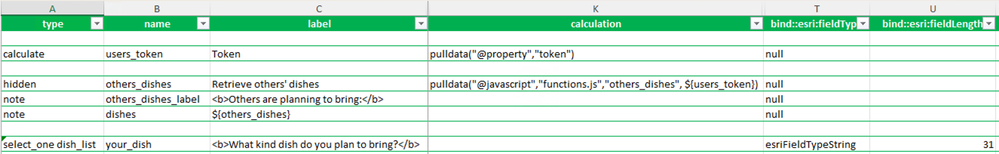

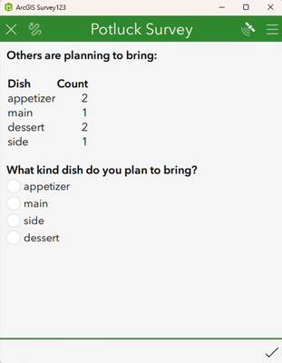

@Mario, if you are comfortable authoring in Survey123 Connect and using pulldata() with custom JavaScript functions, then here is a potluck survey example that might be a helpful model on which you can build. When a user is filling out the survey to indicate what type of dish they are bringing to the potluck, it displays a table of the dish types and counts that have already been submitted:
Note that Survey123 custom JavaScript functions impose some key constraints on the approach outlined here: the survey cannot be shared publicly, and only members of the survey's owner's organization can submit responses (see Known limitations.)
To create your survey in Survey123 Connect, you can put the following in the XLS form's survey tab:
The calculation for others_dishes uses pulldata with the custom JavaScript function others_dishes (see below). The function returns a HTML-formatted table with the dish type counts, which is displayed to the user via the dishes note type question.

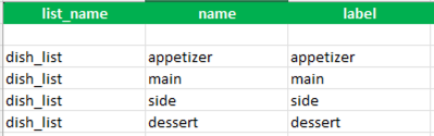

Pair the above with something like the following set of dish type options on the choices tab:

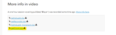

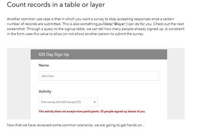

@PeterKnoop There is an example at the bottom here (https://community.esri.com/t5/arcgis-survey123-blog/survey123-tricks-of-the-trade-pulldata-quot-laye...) that explains how to get a count from a pulldata query.
Presumably you could  could set up a query for each category by adding a where clause to get totals.
