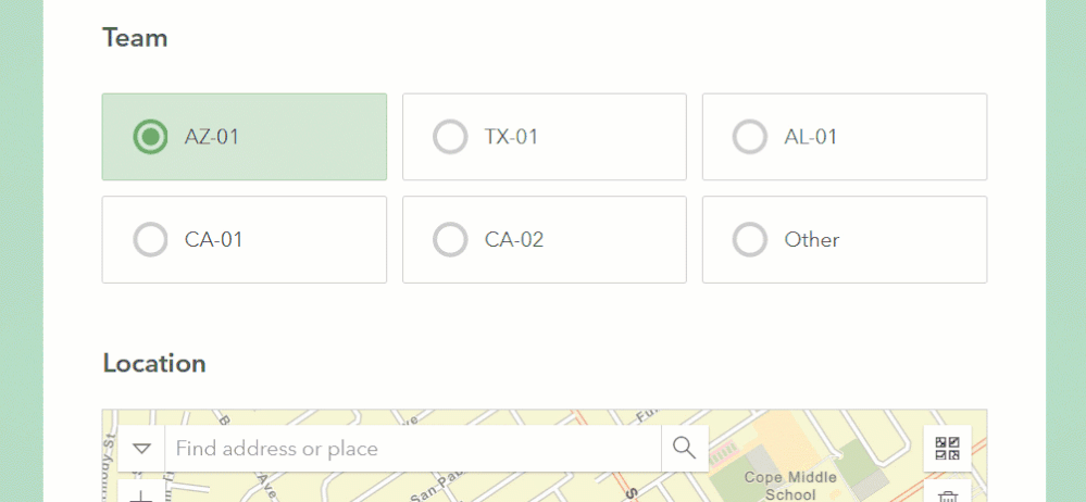

Sometimes, you need more flexibility and let people enter choices not present in the list. Adding a choice called 'Other' is the typical solution to that problem. When the 'Other' choice is selected, a free text question is shown so the respondent can enter a value not present in the list, as shown below:
In the example above, despite adding the 'Other' option, we are still working with a closed list.  Any extra values manually typed will be recorded, but not added to the list. Whatever value is typed under the 'Other' category, is saved in a separate field and the main list remains untouched (closed list).

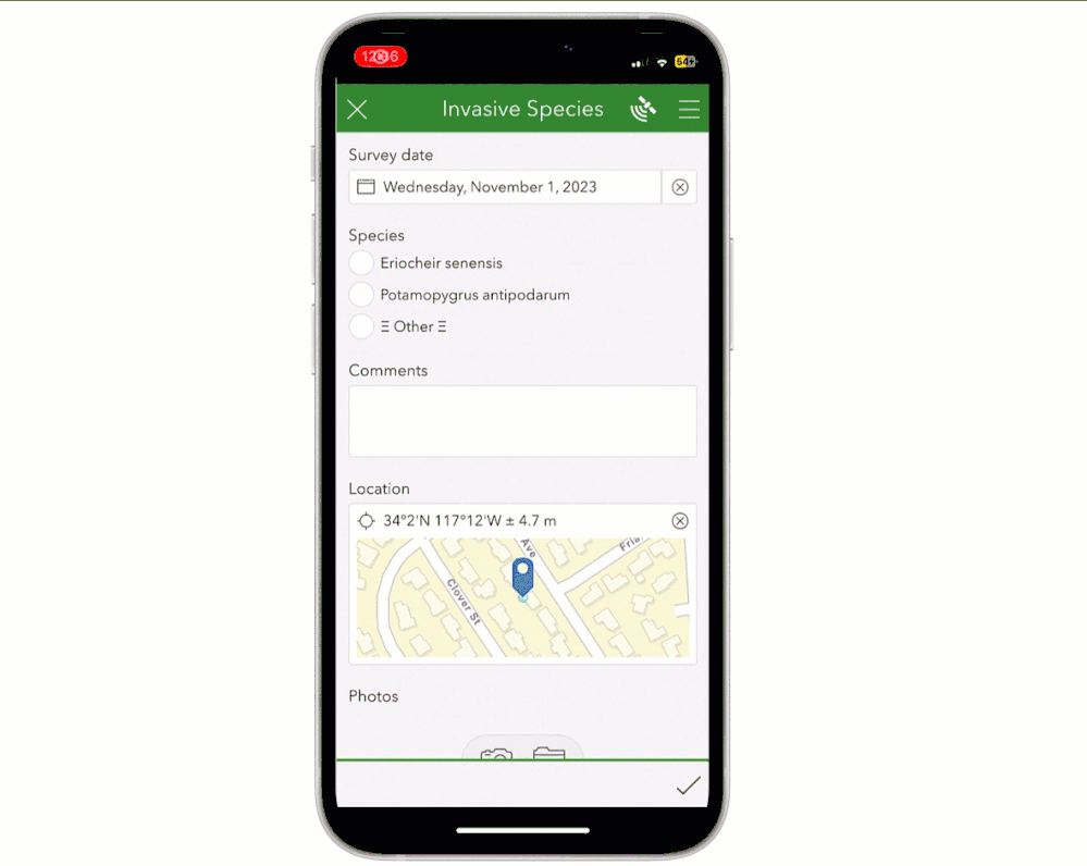

Open lists are different: They automatically grow as respondents add extra values.    Can't find a value you want in the list? Select Other, type it in the free text question and submit. The next time the survey is opened, the new value will show up in the list!

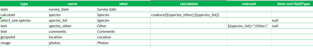

Add now a new text question to store extra values. In the form below, I called the question species_other. Set the relevant expression so this question is only shown when the value Other is selected in the list.  Set the bind::esri:fieldType column to null for both the list and free text questions as shown below:
In the species question, you are going to enter a calculation to auto-populate the value using either the extra value entered in the species_other question, or the selected value from the species_list list. This is accomplished through the coalesce function. For example, coalesce(${species_other},${species_list}) will return the value entered in the species_other question and, if this value is empty, will return the value selected in the list.  This calculation does the trick, as it will populate the species field, which ultimately is the source of all values presented in the list.

The next time you open the form, your list will show a choice in the list for Other. At that point the Other question will appear. After entering an extra value in the Other question, the species field will be populated accordingly.  I am sure you now understand how this works!
Naturally, you will not want to show the species text question to end users. In the XLSForm, change its question type from text to calculate (or hidden).

If you add the tilde or Xi, to your data, you will also want to adjust the relevant expression accordingly. For example:
For cosmetic reasons, I added Xi as a prefix and a suffix. You choose what you like better.
