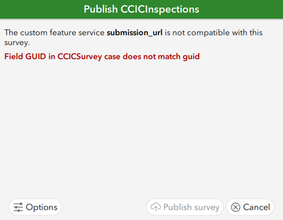

I have a feature layer and a table which are related. When I input a survey the GUID matches the Global ID from the parent layer as it should. But when I am in Survey123 connect and publish, I get the error "field GUID in CCICSurvey case does not match guid".  I am not sure what that means since it does work.  Any help is appreciated. Thank you. Annette

If you check the Fields tab for the layer in your organization the question name in the XLSForm will need to match the field name.
