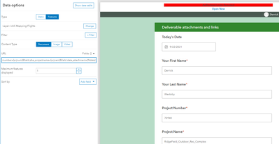

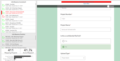

Here's one that I have embedded in a dashboard, with the "UAS Mapping (Completed)" list on the left being used to pre-fill some of the fields in the "Add New" S123 form (Could accomplish the same thing with pop-ups in that feature layer to launch in a new tab)
And here is how it's set up in the dashboard (highlighting that it's only drawing from one feature layer)
I suppose you might be able to accomplish drawing from more than one layer using the arcade expression functionality that's in there now, but I haven't ever tried.
