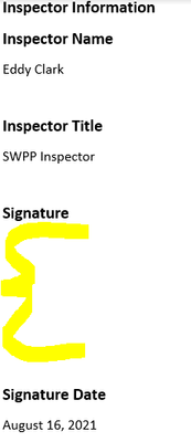

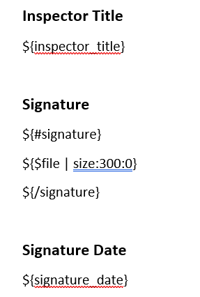

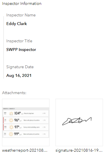

I cannot get attachments to export in Report, even though they appear in the Preview.  Screenshots are from the generic templates generated by S123.  This is true for all attachments - in parent table and repeat table - not just the example I've shown below.
EddyClark
Add this to the end of your doc.
${#$attachment}
${$file | size:350:0}
${/$attachment}

EddyClark
Just found this, which is my problem:
  • The inclusion of any type of feature service attachments (photo, signature, annotated images…) is not supported when your data is hosted in ArcGIS Enterprise.
https://www.esri.com/arcgis-blog/products/survey123/announcements/introducing-survey123-feature-repo...

EddyClark
${#$attachment}
${/$attachment}
