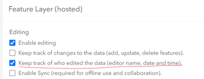

If your feature service has editor tracking enabled:
it will have a creator & editor field, the creator field will be the username for the user who created the record and the editor field will be the username for the user who last edited the record. You can include these fields in your report template to populate this information.
