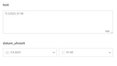

Hi @abureaux,
thank you for your reply. I have tested your idea with the text field. I think I know where the problem is. Using the German profile I am getting the following output:
As you can see: Day and month are switched comparing the textual output and the output in the date question. If I am now getting a date like this:

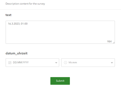

The date question is empty. This makes sense, because the system switches the day and month in the background and tries to set the value 16 as a month. That is not valid.
So I think I will maybe report a bug.
