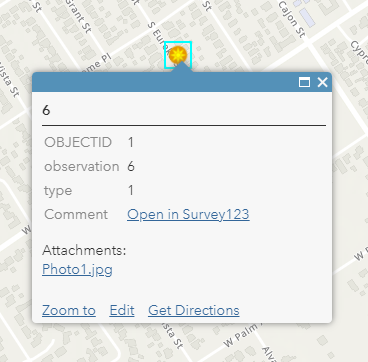

in web map i configured it as
<a href="arcgis-survey123://?itemID=111111111111111111111111111&field:Address={LegalAddress}" target="_blank">Inspection Survey</a><br /><font size="4"><br /><br /></font>
LegalAddress is the field name in feature service

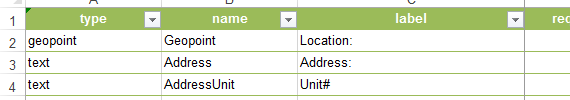

and in survey123

If your updating an attribute all you need is  arcgis-survey123://?itemID=11111111111111111111111&field:Address={Address}
Popup
this blog article, also may be of interest.  https://community.esri.com/groups/survey123/blog/2018/03/30/using-app-links-to-launch-survey123-from...
