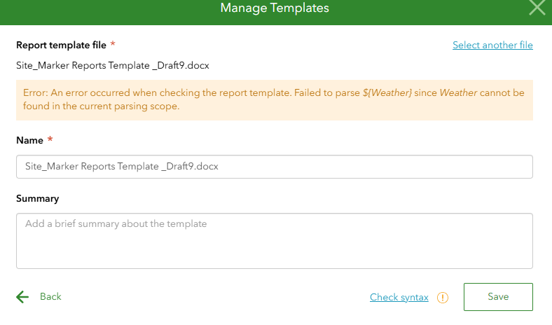

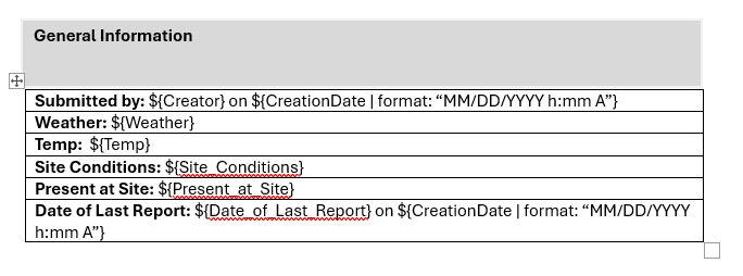

I keep getting this error but I am sure I am following the proper format that Survey123 Report Syntax says for questions using the ${question_name} for a row that I have Weather for a table. I honestly am not sure what error I am making. ThanksScreenshot 2025-05-13 145126.pngScreenshot 2025-05-13 145148.pngScreenshot 2025-05-13 145420.png

Does Weather happen to be in a repeat?  Pulling repeat data in needs special tags:
https://doc.arcgis.com/en/survey123/browser/analyze-results/featurereport-repeats.htm
