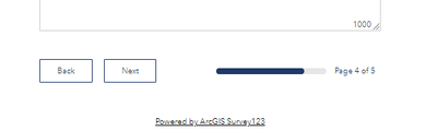

The problem happens when I start to register data inside the web form. At the beginning I get the correct number of pages:

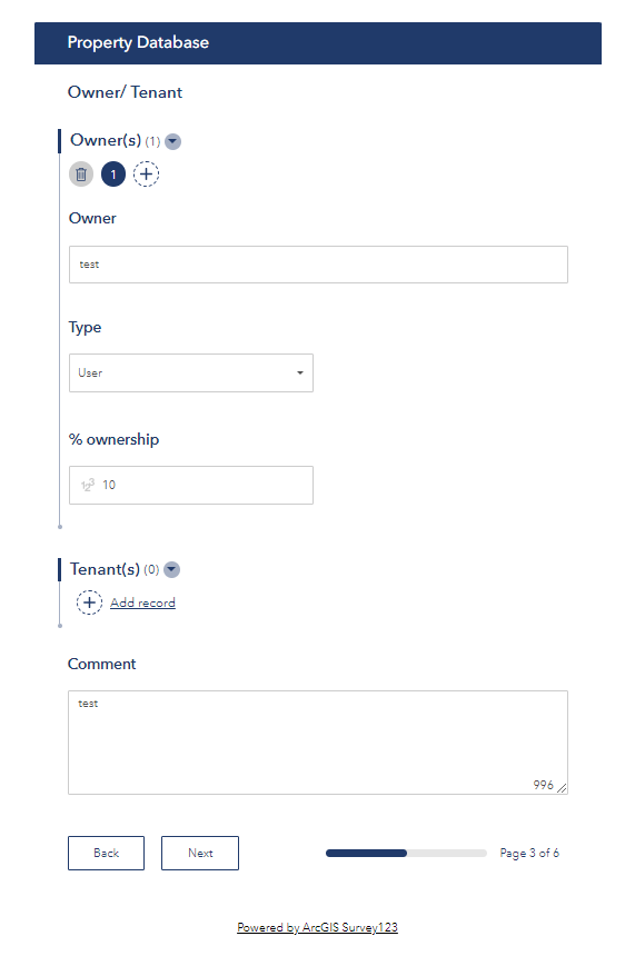

However, after filling out some attributes it is changed to "Page x of 5". I noticed it happens after filling out repeat question on page 3.
After clicking "next" I am moved on the page 4 and get "Page 4 of 5".

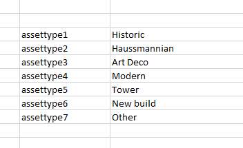

Only thing that jumps out at me is these special chars.  I would try removing them to start with and see.  I could see maybe see issues with # employees and % ownership.  Special chars can get you.
Unrelated I would suggest making your name and labels the same in your lists.  Name is what is actually stored so if you ever push to other software, export, etc you will lose the meaning of all of these and it will just say assettype1 and no one will know what that means.  It will cause you a data nightmare for years to come.   No one likes lookup tables really so just make them the same.

What I noticed is when I leave page 3 empty, fill out some fields on the page 4,5,6 and then go back to the page 3 and add some owners/tenants, then the page 6 does noe disappear. But when I fill out some fields on the page 3 first, and then want to continue, the page 6 is already not there. So maybe it might be something with related tables, since fields on page 3 are constructed as repeats? It looks like a bug, but I cannot find an issue.
