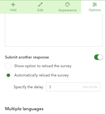

If you've created the survey in the web version of Survey123 you can set the survey to automatically reload when a survey is submitted.

I appreciate the reply. I may have to look into using the web app for this. Thanks for your help

I would suggest looking into URL parameters if you're using Survey123 Connect. I believe you can add the following to the end of the url:
?autoRefresh=true
