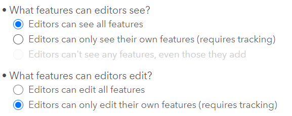

Hi
I need
1. user 1 with role A to only be able to edit the asset features they create
2. user 2  with role B to be able to create a related inspection record for the asset and not be able to edit any other inspection records created by other users with  role B
So in AGOL I  set up a feature layer view on the feature service

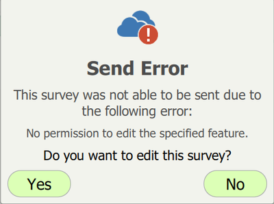

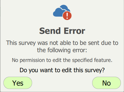

User 1 with role A creates the parent feature in S123 with the "create feature form" - created by field = user1
User 2 with role B logs in and uses inbox to view the parent feature in the "create inspection form"
If user 2 tries to edit a parent feature field and submit the form then S123 behaves as I would expect (send error), but if user 2 only edits the related record  the same error is shown.
No edits are being made to the parent owned by user1 so why is user2 not allowed to create a new record?  something to do with the relationship class?  or is a submission treated as an update event to the parent too by S123?

I've tried the same editing scenario by adding the item to Pro and same issue, Pro won't let another user add a related record t the parent if the parent is created by another user - so not S123 issue - just facet of AGOL authorisation model
