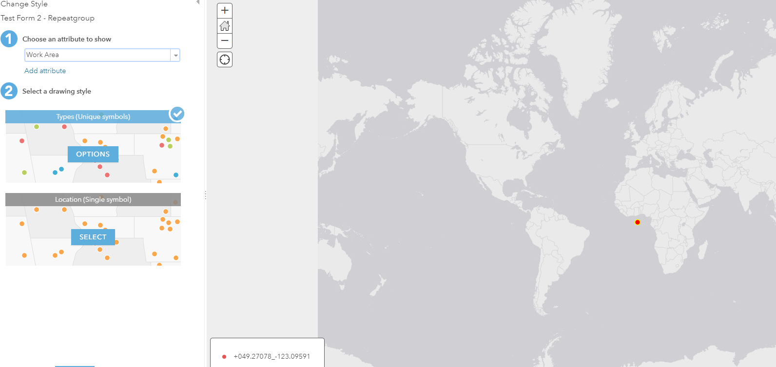

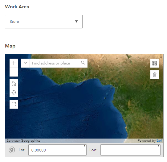

In the survey, when I make the selection the geopoint map doesn't show the correct location
The geopoint data does show up in the feature layer data page, but on the map view, the geopoint doesn't show correctly (this location should be in Vancouver Canada)

I think you need a space between the numbers.  It is hard to see in that post you linked but if you copy paste the code from there you can see the space that you are missing.
concat(substr(${cities}, 0,10)," ",substr(${cities}, -10))
Hope that is it.  Seems like a weird way to do it but I have never tried it.  I am not sure why you cannot just store like  49.55 -127.66

Oh that has fixed the whole issue, thank you so much! 😄
Yes it would be ideal if the latitude & longitude could be stored without the extra symbols added and replacing the space.. Seems like they are needed since space is not allowed in the name column

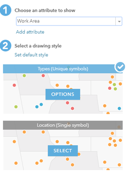

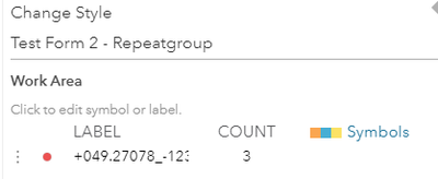

Query 1: The geopoints are showing in the correct locations, but in 'Change Style' the map does not give me a Counts and Amounts option to let me control the circle size according to the count number.
This is even though the map counts the number of entries with this geopoint as more than one (3)

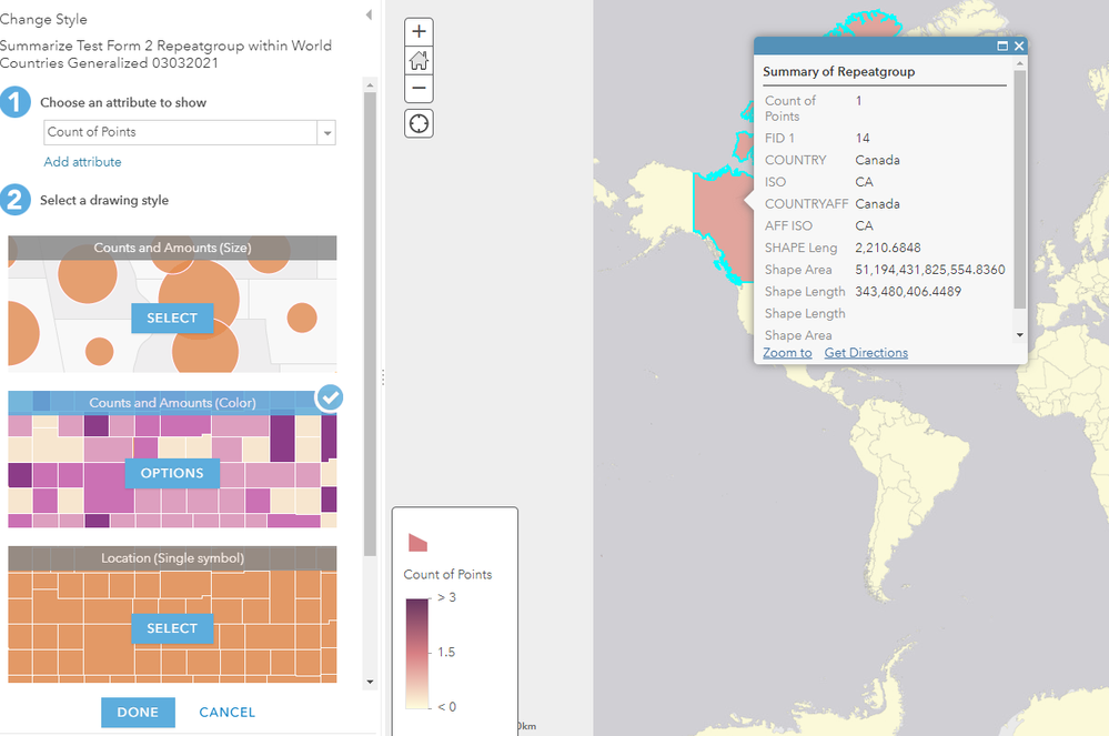

Query 2: I am hoping to make a different map with similar data, but a world choropleth map. I used 'Summarise within' function in the analysis, with the above feature layer and the ArcGIS world generalised countries shapefile layer. The option for Counts and Amounts (color) is given, but the count for the country shows as 1 when there are 3 entries for within the country. I thought this might be occurring due to the 3 geopoint entries being the same (overlapping), but my other geopoints within another country (2 different geolocations which do not overlap) also show as count of 1 in the country.

Query 1 you have work area picked which is a string prob - so no counts and amounts there.  Symbols show ranges of values (like 3 features with 10, 20, 30 values) they will not auto count the number of features for you.  You have to summarize for this like you do in Query 2.  I am not really sure what you are trying to map here.  If you want to see how many are in that exact spot then something like the new Clustering may work enough for you.  But it will not just group the 3 points for you.
The Query 2 I really have no idea.  Maybe you counted the main form instead of the repeat?
Sorry hard to tell without seeing it.

For query 2, I used Summarise Within with the World generalised and the Repeat layer which contains the Work Area data, and not the main form parent layer. I will try query this issue with the ESRI support and see what they say.
