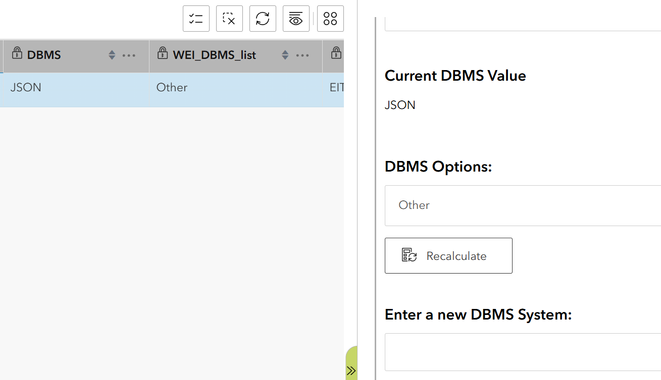

Thank you both for all the inputs. As I mentioned before, I am trying to minimize the number of fields in the feature class. So I tested adding a true field for the dropdown list.... everything is working fine EXCEPT if I select the Other option.
ex: Original WEI_BMS field has value of JSON, I update the data using the dropdown field (WEI_DBMS_List) to Shapefile and Submit.... both fields have the Shapefile value
If original WEI_BMS field has value of Shapefile, I update the data using the dropdown field (WEI_DBMS_List) to Other ... then I get the option to add a new value: let's say I add KMZ and Submit.... WEI_BMS field will have KMZ and the new WEI_DBMS_List field will have Other has a value.
I added a pulldata formula in the Calculate and if I click Recalculate I will get the JSON there. I don't want users to have to click to refresh the data.
So how could I pass the WEI_DBMS value to the dropdown list if the value is Other?
