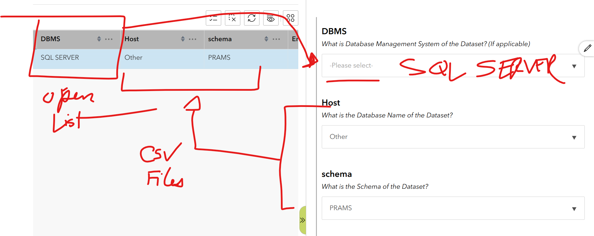

Hello,
I am following the steps from this post Open List and it's working fine to ge my unique list of values in the dropdown list
https://community.esri.com/t5/arcgis-survey123-blog/survey123-tricks-of-the-trade-open-lists/ba-p/11...
However, when I Edit the survey, I "loose" the original value that was entered. How can I retain the original value when I am in edit mode?
- I've tried Calculated field , not working
Attached the section of the spreadsheet showing above.
The process is working fine with CSVs... I just would like to be able to use the "live" data from the map service as users start to add more options for each dropdowns.
Any help or suggestions would be much appreciated.
Thanks!

ChristopherCounsell
MVP Frequent Contributor
Your field binding is null for the question. You're using this and a calculation to populate the actual field that's hidden in the form.
It means that no field is created for the question with the drop down. No value is submitted for that question, and won't appear again when editing.
You need to consider:
  • Removing the null bindings (create a field to store the user interface value)
You could also review the whole setup, use calculation modes, but I think it'll get messy and introduce loops. Adding the field is the most straightforward solution if you are editing these values later
DominicRobergeIADOT
Hi @ChristopherCounsell
Yes, I have 2 "dummy" fields as NULL used as place holder (one for the dropdown list and one for the "Other" option). I do not want to created true fields has I want to use this process for the entire survey and I have about 10 questions with dropdown list.
The current process work GREAT if I create a new entry from scratch. How could I make use of the search functionality to populate a dropdown using live data from the map service, with an Other option in case of a new value for that dropdown and retain the existing value.... all that without having to create 2 extra fields in the layer.
Thanks!

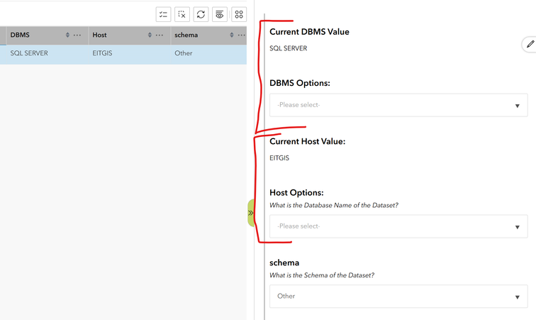

Neal_t_k
MVP Regular Contributor
So I think to solve your issue and show what was submitted when edited you would have to unhide your "calculate" field. You could set it as read-only.  Your current select-one field would remain blank on edit as it is set to "null" but the read-only field would show as the last submitted entry. However that would update on entry (which I think is the point). I made the changes in the attached.

Neal_t_k
Could you do a pulldata @layer function to pull in the last entry and keep it independent from the current form calculations? i.e.  keep your calculate field as was (hidden) and make a new note field (can even be null type) to show what is currently in the database for that particular submission?  That would eliminate an funky if() interactions.
DominicRobergeIADOT
it just make the survey too cluttered.. my users will get confused with this interface.
I would probably need 2 surveys: One for initial data entry and one for data editing.
Neal_t_k
Instead of putting as a separate field, what if you put it in the label or the hint?
