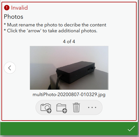

Hello all,
I tried a syntax for 'one image question with multiple photos' that was introduced during UC with Connect 3.10 version, but it does not seem working yet. Is it part of 3.10 new features or the later version?
The name of photo label is 'multiPhoto' and I used 'count-selected(${multiPhoto})<4' in constraint and 'multiline' in appearance. Also method=camera in esri body style does not seem reflected. Could you anyone advise if I miss anything?
Cheers,
K

Hi Kerry,
I just tested your xlsx form in 3.10 Connect and field app and it is working as expected without making any changes. I am able to add multiple photos to the one image question, and when I add 4 photos (your constraint only allows 3 photos), when I try to submit the form I get a constraint validation message as expected.
I would suggest updating the constraint message to be more informative regarding the number of allowed photos.

KerryKang
Hello Phil,
Thank you for taking a look into my issue. I confirm that it worked after updating the survey123 mobile apps.
