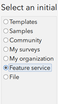

I think you can convert that .xlsx or .csv files as Feature Services and use Survey123 Connect to Publish Survey123 form by Selecting Feature Service option as below.
