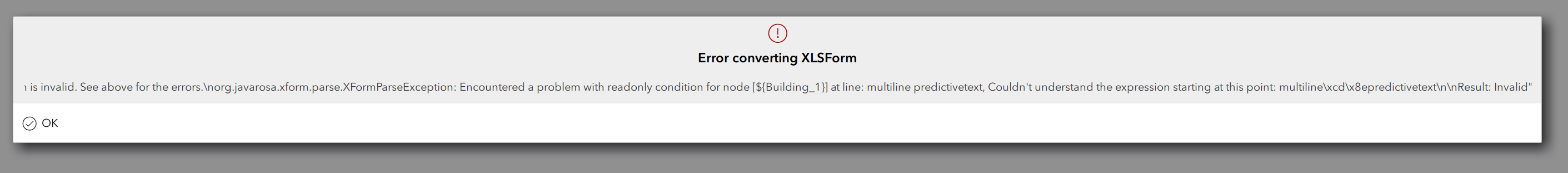

I am trying to create a survey using an xls form in Connect however am getting this error:
"Encountered a problem with readonly condition for note [${Building_1}] at line: multiline predicitivetext, couldn't understand the expression starting at this point"
Any pointers on how to fix this? I have attached the xls form below.

Looks like you did a copy/paste from a diff form and the columns did not line up correctly.  They changed the order a bit ago so old forms will not paste in correctly.  Like you have field-list for read only which is not valid (just yes/no).
Also it is complaining on links.  This means you used Ctl-C V which makes a link to the original sheet.  You always want to right click Paste Values in 123.  All your drops downs are messed up now too.
I suggest you start with a new survey and go column by column and use Paste values to clean it all up.
Hope that helps

Hi Doug,
That did the job, thank you! Helpful to know 🙂
