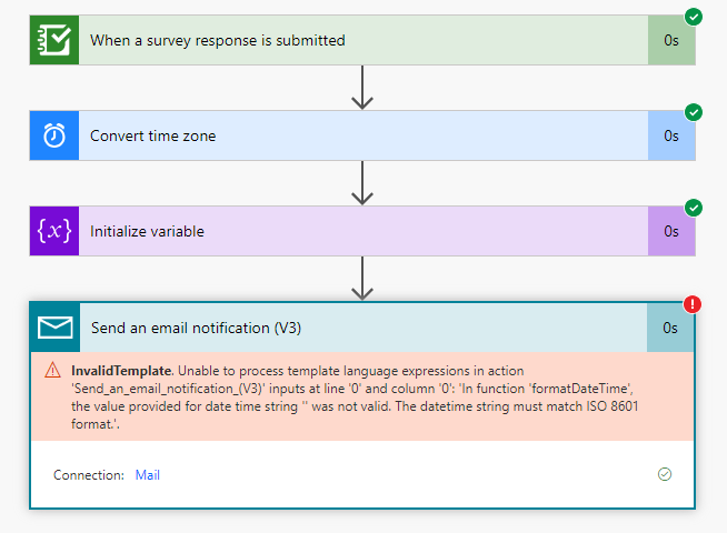

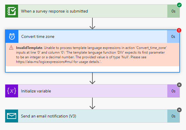

Because the Date and Time fields are optional and sometimes not used, they come into Power Automate as NULL which throws an error message. How can we allow NULL values in Flow or replace the NULL value with a string 'no information provided'?
These are example of the errors.
The Survey has date but NO time
The survey has NO date but has time
DarrenLloyd__DOIT
I ended up using a Condition Control (yes or no) with a Compose data operation for No Date and Yes Date.
abureaux
MVP Frequent Contributor
You will need to user either parallel branches or a conditional statement (probably the more natural choice of the two).
DarrenLloyd__DOIT
