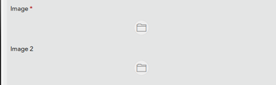

I am not able to control the source of my image question. No matter what I set the body::esri:style to (method=camera, method=camera,browse or leaving it blank), I only see a folder in Survey Connect. I've updated Surevy123 Connect but it didn't change anything. Anyone have any suggestions as to what is going on?

If the Windows machine that Survey123 Connect is running on does not have a camera (or if its camera is disabled) the camera button will be hidden on the survey form. Could that be the case here?
Please try publishing your survey and opening it in the Survey123 field app on a device that has a camera to verify that you can see the camera button for your survey.

Yes, that was it. Sometimes I unplug my webcam when I am not using it. When I plugged it back in I can see the camera in Survey Connect. Thank you!
