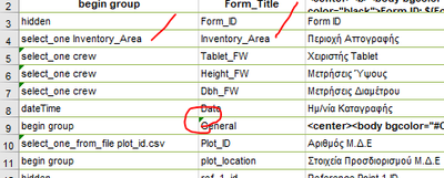

Hi, it seems other users have stumbled upon a similar problem.
I have a form where a select one question depends on a choice filter.
Upon saving the xls file, the form cant be updated in Survey123 Connect.
The error is something like "The same instance id will be generated for different external instance source URLs."

Not sure if this is it but it is all I see.
Using a list name that matches a field name can cause issues.  Add something like List at the end.
Also you are using a reserved word.  That is what the green mark means.
Hope that is it.
Cyprus_Forest_Department
So I did some changes but to no avail.
The error is the same and it mentions something csv related, since I m using some pulldata expressions.
FranjoDamis
It is indeed connected with csv, the solution is to rename the csv file and use it in the form again, but newly created csv file name, and there will be no error.
