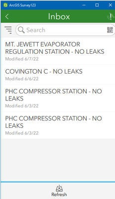

however it does not appear to be working:
There are 3 of the conditions in the nested if statement within the 4 surveys that are submitted.
Suggestions?

Attached is the survey form and .csv file associated with barcode scan. I have been able to get this to work by using the boolean() and not(boolean()) functions instead of string-length(). I have also found that the html formatting (<div style>) as stated here: https://community.esri.com/t5/arcgis-survey123-blog/survey123-tricks-of-the-trade-quick-guide-to/ba-...
doesn't work and I have to use old reliable <font color="blue"><b> html formatting.
This is all being done to differentiate surveys in the Inbox. It would be great if we could set up multiple Inboxes instead. I have added this to the Ideas section.
