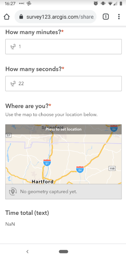

I designed a question to calculate a "time as text field". For example, the user enters in how many minutes & seconds (two separate fields) it took them to complete a task. The purpose of the field is to display minutes & seconds as "mm:ss".

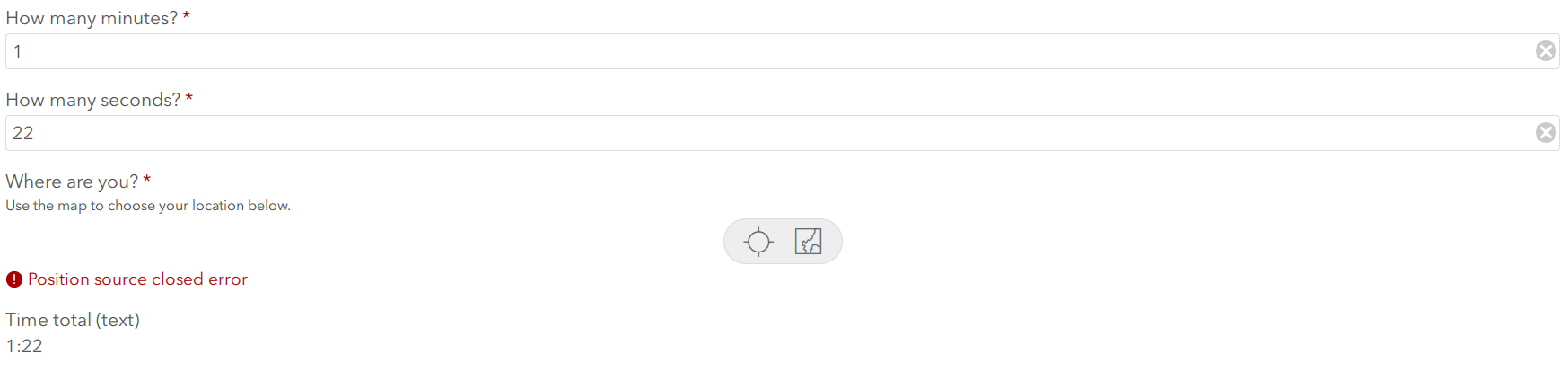

I observed that the formula works as expected in Survey123 Connect. However, when I use the mobile app (in Google Chrome, Android 11), the field only shows as NaN.

Hi @MGAL
What calculation are you using to concatenate the mm:ss string? Note that in the web app, the concat() function is the way to go for concatenating strings (the "+" operator will return NaN). So your calculation could look something like
concat(${minutes},':',${seconds})
The Formulas documentation has more info on functions.
Hope this helps. Best, Jim
Jim-Moore
Hi @MGAL
