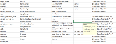

I am using the "note" question in survey 123 connect and I just found out that it will not do what I need.
This is my question that I have built in the XLSForm
Compliant or Not Compliant will not show up in my data export into excel.
this is what shows up in the excel.
How can I get either Compliant or Not Compliant to be marked in excel?  I am wanting to use this a lot in the survey to make collection quick and to show is something right or not.

This works, it just gives me a "Not Compliant" all the time until I hit "yes" that makes it Compliant.
I do not know if this helps.  I am using what you sent and it is working, but when I hit "no" other Not Compliant comes up because the question is not being answered. To show this it will be pic 3.

Try @ThomasHamill 's suggestion and put this in your Compliancebcp field calculation instead of mine.  He was right.  Don't panic, if it doesn't work you can put the old one back, you know it works.  🙂  This should fix the "not complaint" all the time issue.  (Thanks, Thomas, you taught me something!)  lol
if(selected(${ClearSpaceOverlap},'yes'),'Not Compliant',if(selected(${ClearSpaceOverlap},'no'),'Compliant',"))

I have tried @ThomasHamill suggestion and still unable to make it work, have sent him xlsform and hoping he can see what my issue is.

Does the relevant box input need to be different then what I have?  ${ClearSpaceProvided}="Yes"
AllisonHollier
Ding ding.  I bet that's it!  It's only going to use that question if the answer is yes.  Take it out and see.  Bet it works!
But you probably need to do the nested repeats anyway, to ensure a null value doesn't screw it up.  Otherwise, you could just keep it simple and make the yes/no question a required answer so that it has to be either yes or no and no nulls allowed.

If I leave the relevant blank then it works for yes - compliant,  otherwise it says Not Compliant.  Is says Not Compliant until I hit "yes" then it changes.
Should it be that way and is it ok to not have anything in the relevant box?

@BillBlythe, try using the following expression in the Calculation column for the text field you named Compliancebcp:
This way, the Compliancebcp text field will remain empty if the user doesn't select either 'yes' or 'no.'  In other words, if the user skips the first question about the ClearSpaceOverlap or leaves it blank, the compliance status indicator will show neither "Compliant" nor "Not Compliant," but will remain blank
I don't think you need anything in the relevant box for Compliancebcpunless you want this question to appear only for a "yes" answer of ClearSpaceProvided.
Is that how you wanted it to be configured?
