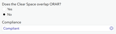

@BillBlythe you could also put a calculation in a secondary text entry field named something like "Compliance" or "Compliance Status," as shown in the images attached below.  You could even make this read only or hidden when it populates Compliance/Not Compliant based on the first yes/no answer.

if(selected(${ClearSpaceOverlap},'Yes'),'Not Compliant',if(selected(${ClearSpaceOverlap},'No'),'Compliant',"))
What am I missing here?  typed it in and gives me an error.

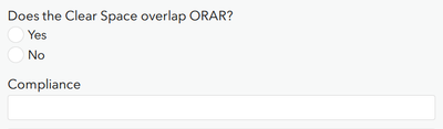

@BillBlythe, the if expressions vary slightly in how they print a result in the secondary "Compliance Status" text field if the user skips or leaves blank the initial select_one yes_no question.
Using the following expression from @AllisonHollier, the secondary "Compliance Status" text field will be populated with 'Compliant' even if the initial select_one yes_no question is left blank.
if(selected(${ClearSpaceOverlap},'yes'),'Not Compliant','Compliant'))
Using the following "nested if" expression, the Compliance text field remains empty (see ending else argument of '' empty single quote) if the user doesn't select either 'yes' or 'no' for the first question (skips or leaves it blank).
if(selected(${ClearSpaceOverlap},'yes'),'Not Compliant',if(selected(${ClearSpaceOverlap},'no'),'Compliant',"))
