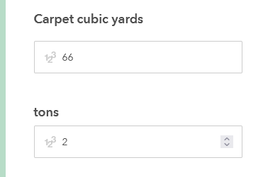

Is it not possible to do this?
${carpetyards} * 84.4 div 2000
 I'm not getting an error but I'm also not getting a result.

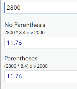

jcarlson
MVP Alum
Not sure how the order of operations works in S123, but I can get a similar expression to work just fine.
How is your carpetyards field formatted? Is it possible the form is reading it as text? When I enter a string like "8,800", it fails to compute.
- Josh Carlson
Kendall County GIS

Josh,
The carpetyards field is an integer type.
It wasn't (isn't) working in S123 Connect, but it is in the web app. Go figure. But, I guess I have a new problem. It isn't showing decimals?
I'm no good at math, but my calculator tells me 66 * 84.4 / 2000 = 2.78.
jcarlson
MVP Alum
You have tons set to an integer as well. Set it to decimal to fix that.
- Josh Carlson
Kendall County GIS
JaredPilbeam2
MVP Alum
That did it. Thanks a bunch.
