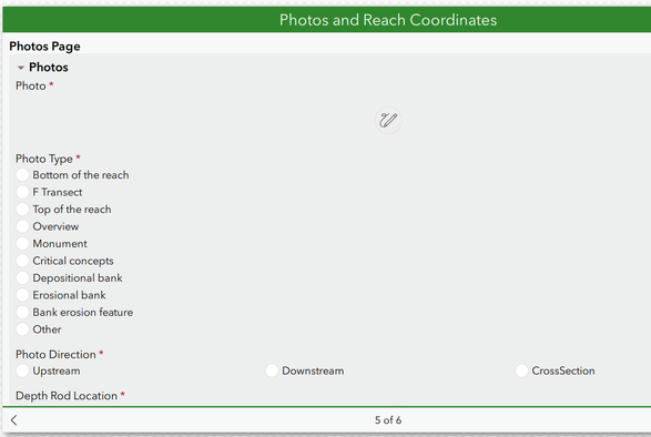

No you would create one repeat with a photo question in it.  The repeat would have the photo question, photo type, and the exif questions, then you can also a geopoint.  You can use a constraint using count() to limit the number of repeats they can make.  In the Dashboard map the repeat vs the form itself.  I bring in any info I need from the parent like project name so I can use filters in my dashboard.

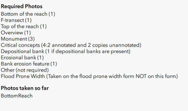

I also created a summary page that lists what the crew took vs what they need.
