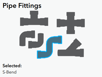

Further to @AllisonHollier's great suggestion for adding images for each choice, you might also want to look into the image-map appearance. This feature allows you to add an SVG image to your survey that has "clickable" regions (linked to a choice list).
Please see the Using the image-map appearance in Survey123 blog post for more details. cc: @BrettStokes
There's also an Image-map sample XLSForm in Connect that includes plenty of examples, including an example somewhat similar to what you're describing (pipe fittings):
Best, Jim

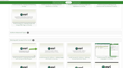

Yes, and there's a great video actually in Survey 123 Connect on how to do it.  At the top of Survey 123 at the main screen beside where it says My Survey Designs, Click the Tutorials Button, Scroll down to the heading Working with Survey 123 for ArcGIS, the second video to the left... ArcGIS Survey123: XLSForm -- Adding Images and Audio in a Survey.  This shoucl be just what you need.
