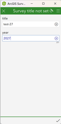

I've built a form in Survey123 Connect where I have a field {title} ending in a 2-digit year ("....-25").  I want to use that value and concatenate it with "20" in field to create a 4-digit year in a subsequent field {year}.  While the preview works in Survey 123 Connect, the published form does not.  Some folks troubleshooting the Connect .xls were able to replicate the problem.
concat('20',string(substr(${title},-2,2)))
The code works as long I don't do both substring and concat, it works in the form.  It will concatenate the whole {title} to {year}, but will never add the substring in the published form.
Has anyone experienced this or suggest a work around (maybe I need to make an interim, invisible field?).

Going off of what @TylerGraham2  said, I looked up some substring syntax.  Try the following calc:  "concat('20',string(substr(${title},-2)))"
This should just be taking the last two characters.

Just checked the substr(${text1},-2) and it accepts that as taking the last 2 characters of a string in the webform.  I didn't think that would work since I can't think of any other case in Survey123 where if you skip a parameter for a function it doesn't scream an error at you.
Neal_t_k
I tried it first and then went back to look at the documentation and was surprised it worked as well!
