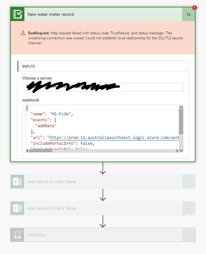

I creadet a MS flow to capture records. This worked fine for quite a while. However, since yesterday I get following error message on MS flow:
BadRequest. Http request failed with status code 'TrustFailure' and status message: 'The underlying connection was closed: Could not establish trust relationship for the SSL/TLS secure channel.'.
The survey is hosted on AGOL.
Even if I create a new connection I get the same error.

An SSL error would indicate an issue contacting survey123.arcgis.com; this is communication between Azure and Survey123 directly.

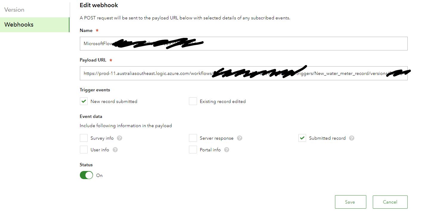

I also had this issue, the way that I resolved it was to use the "When a Http request is received" flow module and set up the webhook via the Survey123 website manually. This module generates a similar URI to the automated one when you set it up in flow in the pre setup manner. Once you generate a sample payload its essentially the same as your first attempt (although you can expose a bit more information with the custom webhook by the looks of it).

What do you need to do I'm happy to help. Initially you need to create a "when a http request is received" trigger which will create a url end point which you can enter into Survey123 website > your survey> Survey settings > webhooks > add webhook and add in that generated URL as the webhook url ticking on the various options. If you need more help feel free to drop me a message.

First create a blank flow like this with no JSON schema:
add the HTTP post url from the above photo as the webhook URL:
Save it and click test in MS Flow
Click ill perform trigger action
When your page looks like this, send a test survey.:
You should then get this:
Click the when a http request is received to see the payload.
Copy this payload to the generate payload button in flow:
Paste here:
And now your custom webhook is setup. It should auto recognise the various elements within the Survey e.g User portal etc.
