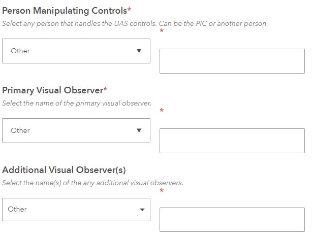

I'm having trouble with a question label not appearing in my survey when it's being used in the browser-based Web App.
This survey has a number of select-ones and select-multiples with an 'Other' choice which triggers a relevant text box for users to enter the name of the Other item. In the web form, the label for the Other field does not show up and the text box is awkwardly to the side. The text box and label display as expected when using the Field App. I've tried some label formatting, like adding a <br>break</br>, but it hasn't solved the Web App issue & makes the Field App look awkward. How can I make the ‘other’ question label show up?

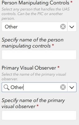

In the web app, missing question label and awkwardly placed

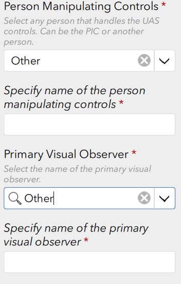

In the field app, with appropriate question label
