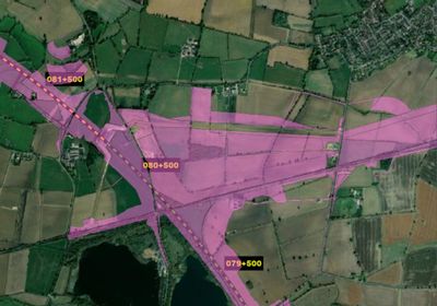

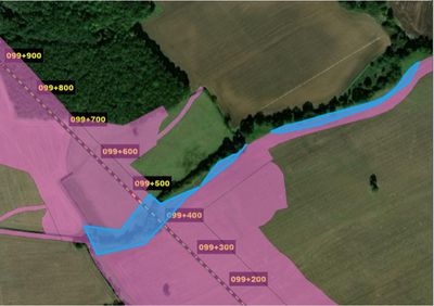

Hi, Since Thursday 28/07/2022 I am experiencing some issues with the map in Survey123 report. For couple months I have been using ${$shape|mapSettings:"48b8097230ba44eb8b6607254865080d"|size:800:500} to show the shape selected for the report. As you can see on image 1 the shape is highlighted. I exported the same map today and the map shows the default extent of the webmap (image 2). Has something changed over the last couple days?
