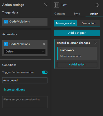

I'm actually running into the same issue as RayKidd, definitely using the same data source and correct {GlobalID} field and getting the same error. I have it set up via list widget, Action->Filter Data-?Framework:
The layer in the map is the same one that gets populated by the survey. Works fine following Isamel Chivite's helpful article on Dashboards but can't seem to get the equivalent in ExB. My embed widget is using the same URL copy-pasted form the correctly working dashboard.
