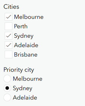

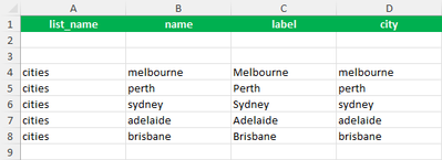

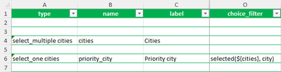

Check out the Choice Filters and Cascading Selects sample in Survey123 Connect for some useful ideas on filtering choice lists. In particular, the Rank example group shows how to achieve what you're after using the selected() function in the choice_filter column. Here's an example:
Survey worksheet:
Choices worksheet:
In the form:
Hope this helps! Jim
