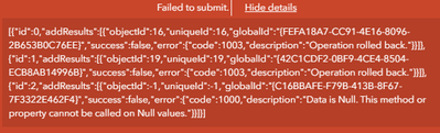

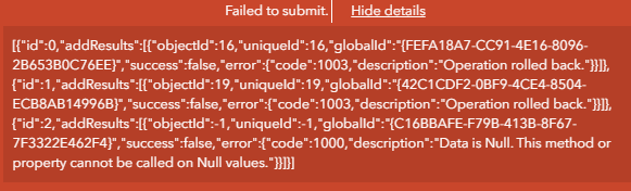

Also, the published survey fails submissions:
What has gone wrong?

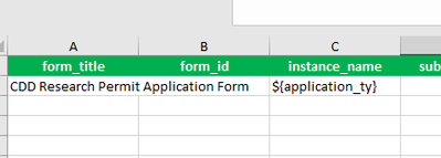

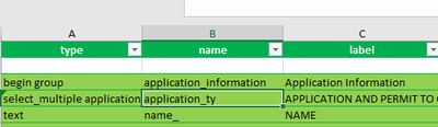

I did talk to Esri team but prior to that I found a way to resolve the issue. In the XLSForm of Survey Connect, you need to set a proper instance name (setting sheet). I realized it has to be the name of one of your fields. I tried a dozen of other names and didn't work. Once I tried the name of my first field, it worked, and I was able to submit a new survey. I don't quite know what "Instance_name" does, but apparently, it makes a connection to the survey file.
Here you can see how I did it:
Survey Sheet:
Setting sheet:

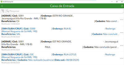

The instance_name defines how the record appears in the field app when a record is edited (editing from Drafts, Outbox, Inbox). It accepts HTML formatting, functions, etc. Here is an example:
I hid personal information from users
As far as I know, the instance_name does not apply to the Web App, because there is no 'record list' for editing (the form opens directly, with all the data). It seems strange that this has a correlation with the problem. In any case, I will do some tests.
