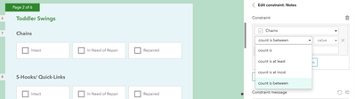

Can you elaborate further? I would like an image question to be required if chains is In Need of Repair but the drop down only gives me a count option.

You want to set relevant on image and the note not a constraint.  I only use Connect so not sure on the web but look for relevant not a constraint.
