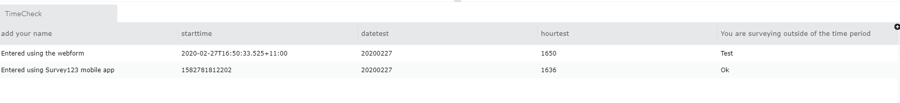

Here's a screenshot of what the results look like (data tab in Survey123.com). I had the survey date set as 20200227 and time between 1545-1645.
Thanks again!!!
