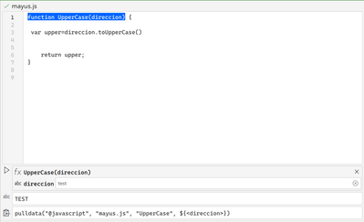

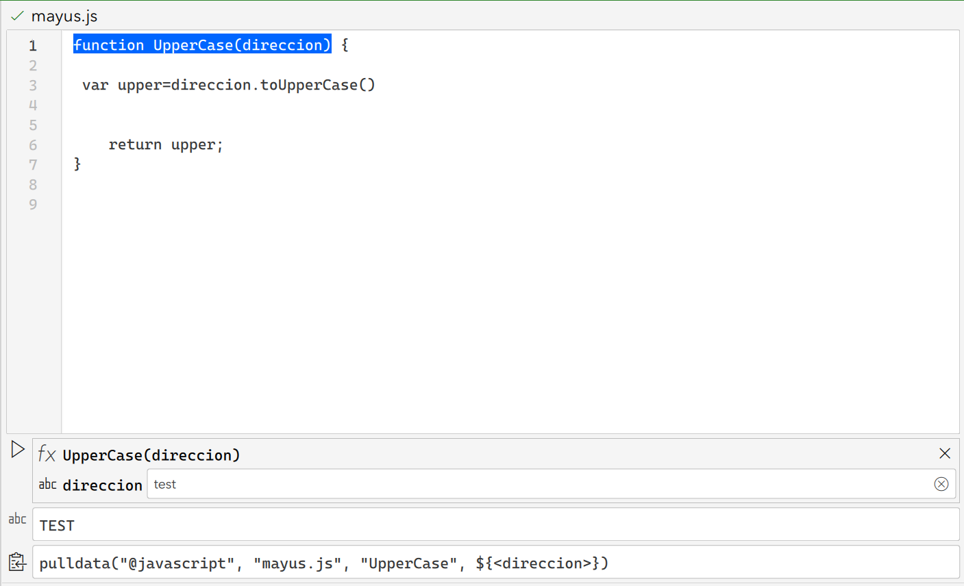

I'm working with a script on my survey:

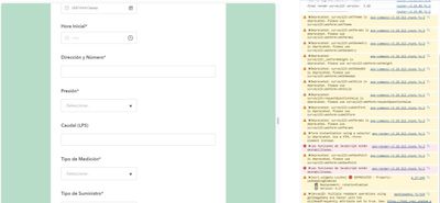

The pulldata and the script are working properly before the survey is published.

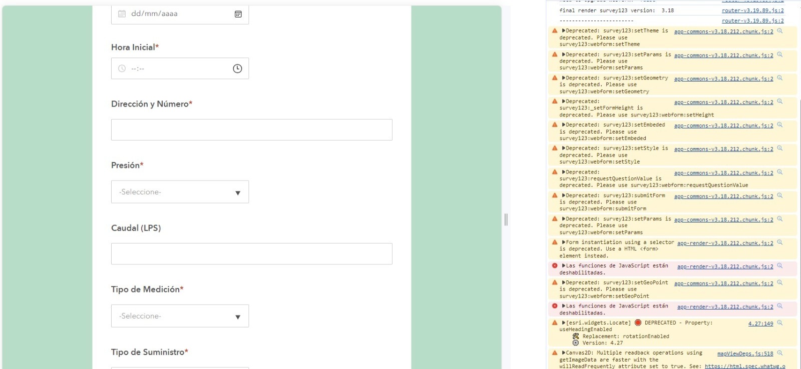

Once the survey is online the script doesn't work. Checking the developer options on my browser I found this message:
It basically says that JavaScript Functions are disabled.
Do you know how to fix this?
I couldn't find an option to enable them.

Are you logged in?  Cannot use JS if anonymous user.  Also cannot use JS across AGOL organizations.

Thank you, I have this survey open for everyone so there's the problem.
I'm trying to make users only write in upper case and the script was an easy solution.
