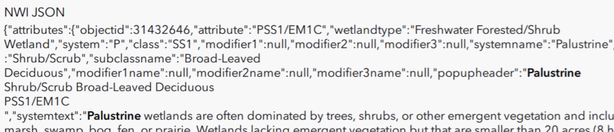

@IsmaelChivite thank you so much for this! It's working.....for the most part.
Sometimes, the query is successful and it returns the JSON, as intended.
Other times, it returns a 500 error.
Also, on occasion I've had it just return '0' as well.
Are these two errors simply due to the size of the service? I am querying this service specifically in my script.
If it is due to size, is there any method to get around that limitation?
