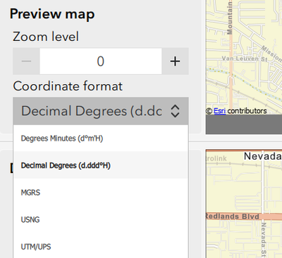

When I use pulldata it gives me DD right away.  Maybe change the settings of the map in 123 to DD?  Tried that?
pulldata("@geopoint", ${PitLocation}, "x")
AbigailStephens
Thanks for the reply @DougBrowning! Unfortunately, I had updated that setting for the survey, but because we are trying to use a Javascript function to convert a list of DMS coordinates like this
36-56.00N 023-29.00E;36-42.00N 023-32.00E;36-41.00N 023-48.00E;36-47.00N 023-55.00E
to a list of DD coordinates like this
36.93333 23.48333;36.70000 23.53333;36.68333 23.80000;36.78333 23.91667
this setting doesn't resolve the error returned by the pulldata calculation.
